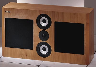

The VOX 251 HE-CENTER is the corresponding centre speaker to match the VOX 251 HE. This is a horizontal speaker equipped with identical drivers. The TIW 250 8 Ohm bass speaker and a BR 14.70 tube are positioned to left and right of the mid- to high-range unit, which is arranged vertically, behind a fabric-covered frame. If required, the drivers in the speaker can be fitted with compensating magnets to shield them magnetically. The VOX 251 HE-CENTER has the same excellent soundproperties as the VOX 251 HE. The reproduction of the unbelievably sonorous low-range bass and, at the same time, extremely clear-cut mid- and high-range reproduction, is mastered effortlessly by the VOX 251 HE-CENTER. This centre speaker is the ideal choice if you want to build up a multi-channel system around the VOX 251 HE, that will appeal to both seasoned music lovers and aficionados of the cinema.
